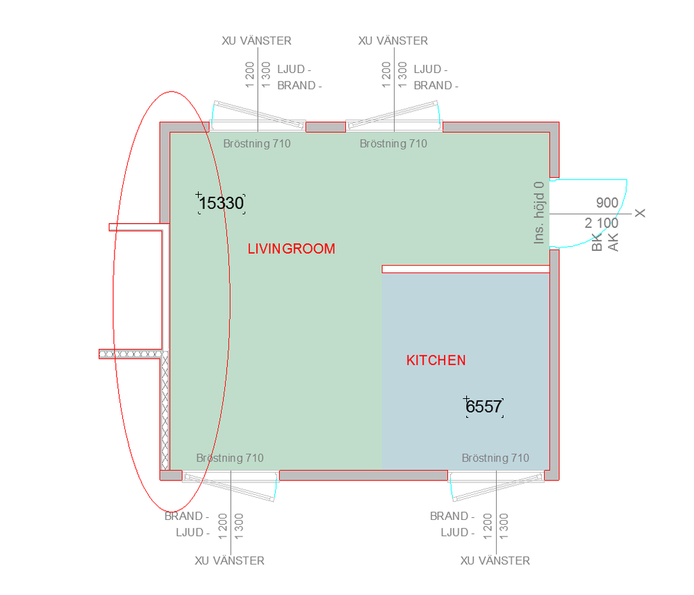

I have a request from my contractor to calculate wall areas for wallpaper and painting.
I would like to calculate a rooms wall surfaces and have them listed in a schedule. Ok this I know how to do with a zone but if a wall is divided in parts it's listed by the parts.
I wish to have this wall that consists of three different wall types calculated as one.
Suggestions anyone?

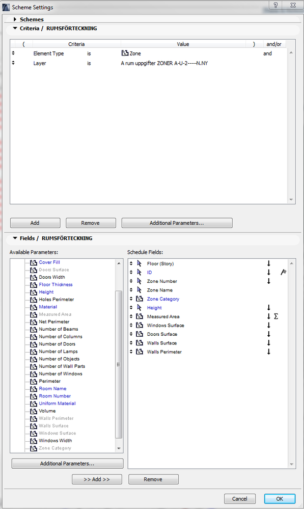

I have not tried this but maybe you could assign the same ID to all 3 Walls, then enable the SUM option for the ID field in the scheme setup dialog.
Yes Laszlo I've taught of that but I don't want to change wall ID's as they are important in other schedules.
I would like the zone to regard it's side against these 3 walls as one surface and then list each side in the zone as one surface
But I cant find the parameter for it.
I've made a schedule that calculates a zone but the wall surface parameter calculates the surface total not the individual sides.

Maybe some pictures will help.
P.S. In this picture the walls have the same ID I know but I hope you understand anyway.
Scheme settings.

I don't exactly understand this because you show screenshots of the Scheme Settings Dialog, which is related to Interactive Schedules, then you give the last screenshot which is the traditional listing type list.
Yes I know it's a bit confusing and I'm confused too
I've tried the Interactive Schedule with the setting shown and didn't think the resulting image would be interesting as it only shows the total surface. I can't find a parameter that shows surfaces divided by zone side.
Then I tried List were I get all the walls surfaces but can't find a way to summarize walls adjacent to a zone side. Picture shows result.
