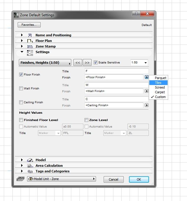

Hello
Is it possible to define the default finish for zones? I want to schedule a lot of zones with different custom finishes and it would be a lot easier to choose from a predefined list.
I am aware of the CUSTOM option, it would be nice if the values could be stored somewhere.
Thank you.
