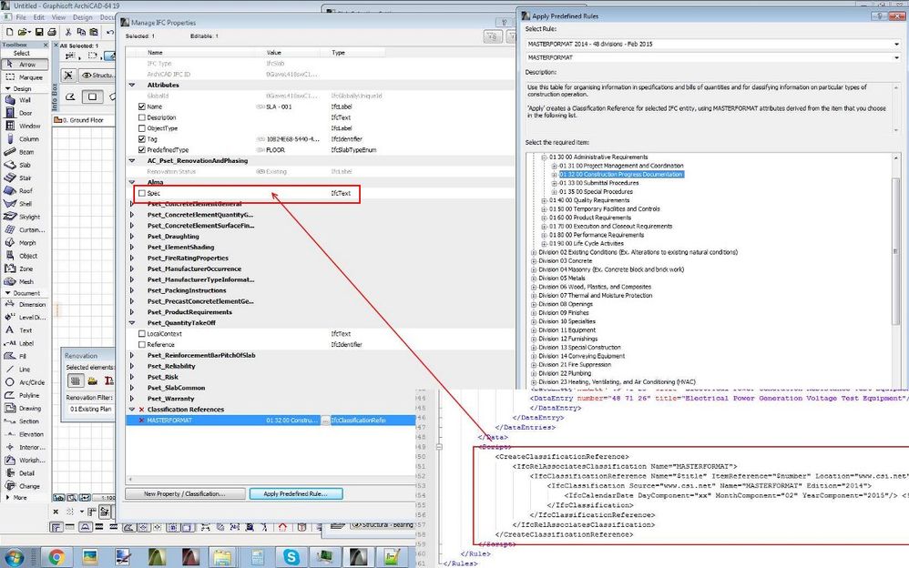

alemanda
does anyone know the syntax how to give a ifcproperty set a value?
In other words I need to know how to assign a string value, for example "demo" to my property set ALMA - Spec.
In this way it would be possible to assign specifications, choosing by a preset list ... It would be great.

alemanda wrote:
Finished.
48 divisions implemented.
At the moment the classifications does not distinguish the type so every numbers can be associated to every item in the model.
