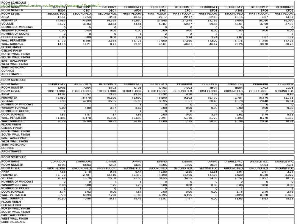

wall finish schedule,.
I put a wall finish schedule table on a panel.
Originally the table is too long hotizontally.
,but I saw some people made it vetically. so I try to make it, but I couldn't.
I want to know how i can make it.

I'm not sure if you can rearrange the schedule in the schedule view, but when put on a layout you can easily rearrange it. Just click on any of the corner points and choose Restructure from the pet palette.
Image added as well

Try changing the field shown in the attached image.
