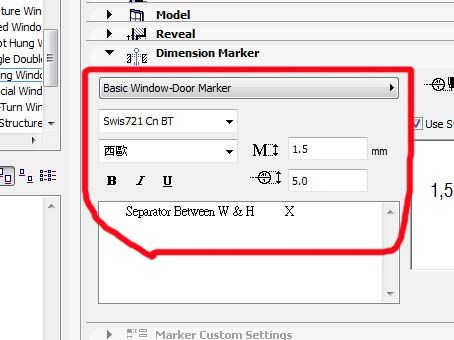

thanks for the reply. Sorry I have not make it clear.
The questions I had is when I placed a window in the plan, and selected the "Basic window marker" it showed the WxH, But I want HxW.
I was interested in this problem and also it turned out the script was not very difficult to modify. So I modified it.
There is a new parameter with which you can set how you want to have it displayed: Width-Height or Height-Width.
See it attached. Have fun with it.

Djordje wrote:
Could you please post it in the Depository?
Done. It is under Depository/08 Doors-Windows/Windows
