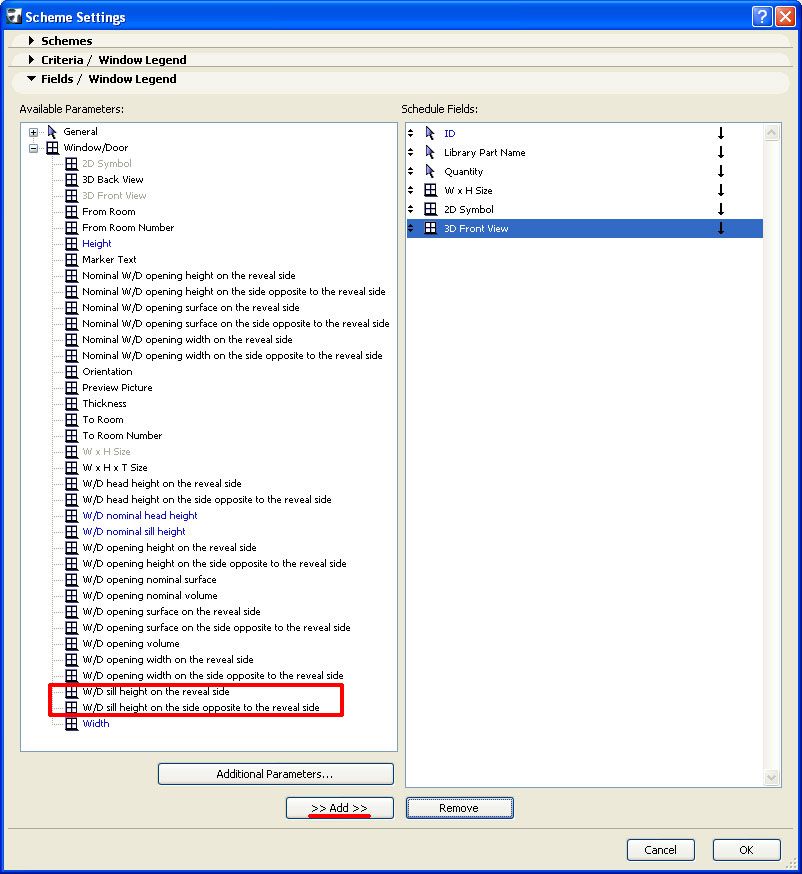

I am trying to complete my first set of CD's using Archicad, and I would like to customize a window schedule to list the sill height. I have tried to figure out how to add this infomation by the manual and help sections, but I still am unable to make it work.

and are you using the Interactive Schedules or the List Schedules?
Tom Waltz
I am using Archicad 10, and I am trying to use the interactive Schedule. I am running this on Windows XP, if that makes any difference.
Link
Graphisoft Partner
In your Scheme Settings, just add the Sill Parameters to the Schedule Fields.

Many Thanks ! That was simple, and I don't know if I would have ever come up with that solution.
