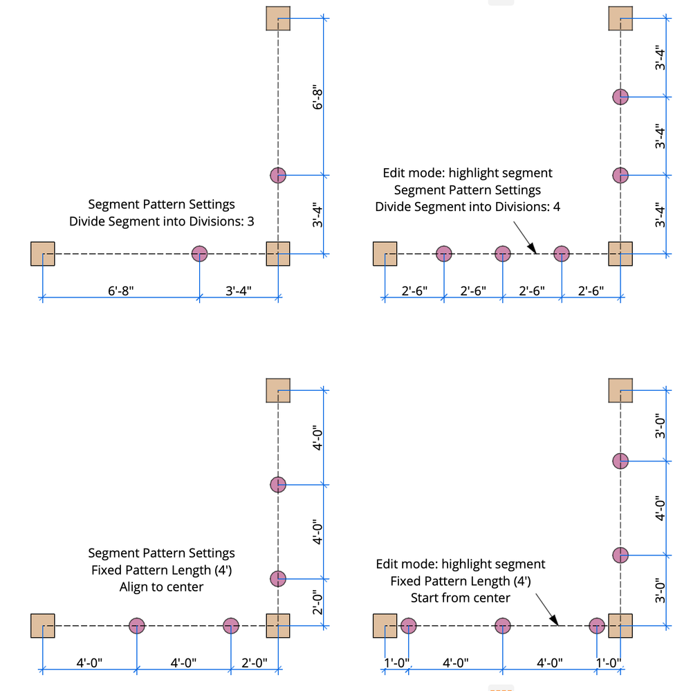

I am very confused about railing nodes and segments and have read similar posts discussing independent railing segments.
For example, if I draw a static "L-shaped" railing, Archicad seems to treat the entire "L" as a single segment.
If I divide the segment into (3) divisions, AC25 creates two inner posts and divides the entire "L" in thirds.
What I want is two independent segments each divided in thirds by inner posts.
When I go to edit mode, highlight the segments and nodes and select one segment and change the divisions to four, the other segment changes to (3) divisions. However, whenever I try to independently edit both segments to the same pattern, AC reverts back, moves the inner posts, and considers the entire "L" as a single segment.
The same is true when I work with a fixed pattern length. As soon as I set the pattern the same, AC thinks there is a single segment and divides the inner posts along the entire "L".
Thus, in the attached png, I am unable to have the upper diagram have independent segments with three divisions, or the lower diagram have independent segments with the posts aligned to center. As soon as I edit each segment to the same setting, AC treats the entire "L" as a single segment.
In the real world, I have a static balcony railing with several turns.  Some segments need the inner posts starting from the center, and other segments need the inner posts aligned to the center.  I am unable to edit independent segments, because as soon as I set any two adjacent segments to the same setting, AC throws the entire string of inner posts out of whack.
Other than splitting the railing, how can I edit each segment independent and have three divisions or both set to align to center.

"For example, if I draw a static "L-shaped" railing, Archicad seems to treat the entire "L" as a single segment.
What I want is two independent segments each divided in thirds by inner posts." @Tincan561
Node => Pattern Continuity => Crop Segment at Node
Ling.

Perfect, thanks
