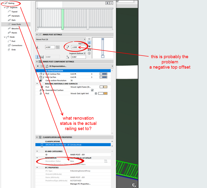

l tried everything indicated but to know avail. As requested, here are my "inner post" settings;
Let me know if you see something. Thanks.

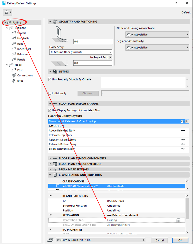

I think the problem is you have a top offset of negative 3 feet?
You will also see what I mean about the renovation status, bit this may or may not affect your 3D view.

Also after reviewing your picture and suggestions I started changing some of the post settings for the post's top and bottom to see how the changes affect the position of the post as shown in the top window. I didn't realize the significance of the box indicating "rail 1" and "absolute", etc. To guarantee that the post was located at the proper height I selected the "absolute" setting for the top of the post and set the segment bottom at 0'. Selected OK and still no inner posts in 3D.

I can't see anything wrong with the settings you show, but check what is the renovation status of the entire railing.
It may have nothing to do with it.
