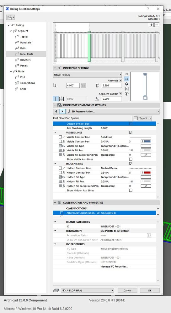

I've had this problem for a while but never gave it much attention but it does help if the issue could be fixed. The problem occurs when I create a "railing/fence". I set all the parameters for all of the pieces of the railing and then place it. In the floor plan the railing is complete with all parts but when I go to the 3D view the fence shows fine except on item. All of the inner posts are not shown. Where the posts are located there is a wide space between the balusters. I checked the Model View window and all parts are selected. I check the railing using the quick edit option on the screen and it shows everything as being viewable except "segments and Nodes". I click and open the eye but no results. I check again and the eye is closed again. Is there a way to permanently force AC to show the inner posts in 3D? As always, any assistance is appreciated.

What are your Inner Post settings?
Segments and Nodes is just a different way to edit your railing in the Edit mode, having if not visible does not affect anything.
Is it to do with renovation filters?
I have noticed it is possible to have a railing that is 'new' but the posts can be 'existing'.
I don't think this is supposed to happen, but it can - the same with stairs.
Try setting a renovation filter that shows everything.
l tried everything indicated but to know avail. As requested, here are my "inner post" settings;
Let me know if you see something. Thanks.
I think the problem is you have a top offset of negative 3 feet?
You will also see what I mean about the renovation status, bit this may or may not affect your 3D view.

As per your picture I checked the renovation setting with the railing selected and it is set as "new". As per the post settings I captured 3 pictures showing the various inner post settings.
Also after reviewing your picture and suggestions I started changing some of the post settings for the post's top and bottom to see how the changes affect the position of the post as shown in the top window. I didn't realize the significance of the box indicating "rail 1" and "absolute", etc. To guarantee that the post was located at the proper height I selected the "absolute" setting for the top of the post and set the segment bottom at 0'. Selected OK and still no inner posts in 3D.
Obviously it would seem that there is a "glitch" in my AC (up-to-date) V26 or there is some switch/filter that is set to prevent the posts from showing. I am at my wits end as I have tried the model view tool for railings and anything else I could think of without any result. Having said that, it's probably a small obvious thing causing the issue. Any thoughts appreciated.
I can't see anything wrong with the settings you show, but check what is the renovation status of the entire railing.
It may have nothing to do with it.
Drag a copy of your railing to the side and play with that.
Change the inner post to a different type, even delete them and add them back to see what happens.
You will be working on a copy so it won't matter if you mess it up completely.
Hello Barry:
Thanks for all of the suggestions and help but no matter what I do (new fence, different posts and settings,etc.) the inner posts just don't show. To show the fence properly I just created a new fence that is less than 1 segment long which generates a post at each end of the fence. I then moved the ends as close as possible and deleted the end post. That left just the start post which I located in the first inner post position and then copied the post using the multiply option. So now my fence looks correct in 3D but is the wrong set of components. I will have to live with that today but it would seem to me that this issue is something that the AC software engineers could shine a light on the issue. Again, thanks.
