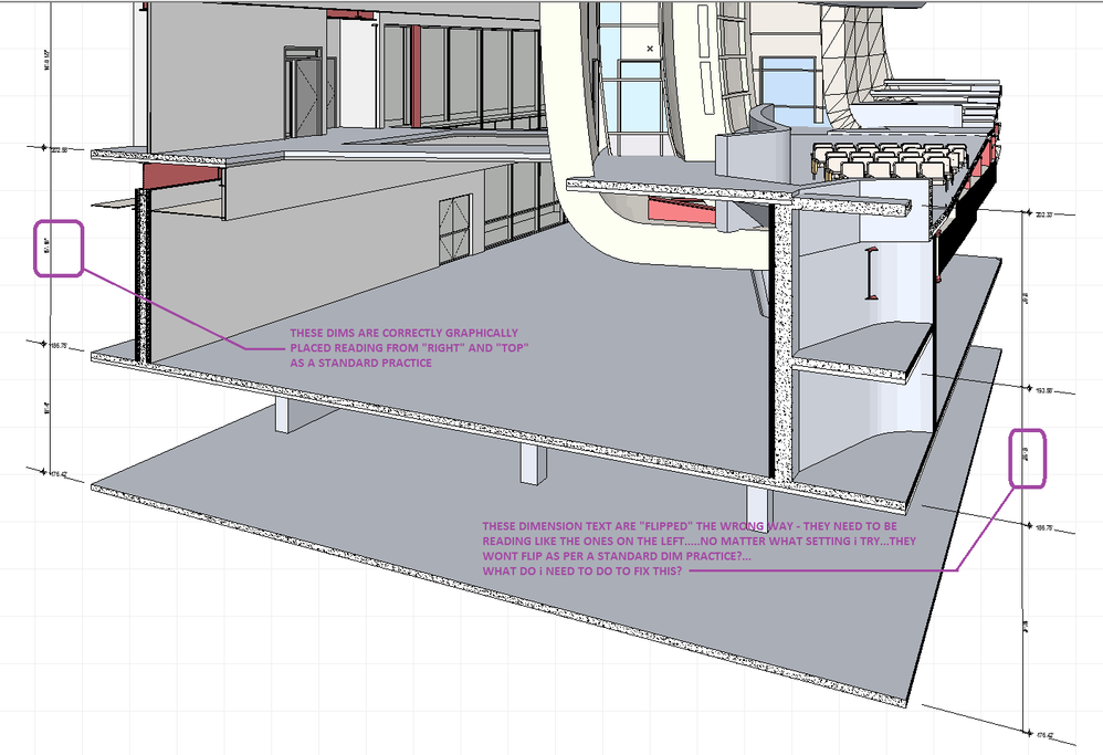

so..the dimensions on certain occasions get "flipped" to the wrong side of the dimension line.
No matter which way I run the dim string....they seem to get flipped the wrong side.
In standard industry (in the U.S. that is) dimensions , notes, text...are ALWAYS READ ON A SHEET either vertically (like you are reading a book) or if you tilt your head the left...they are read from the side(as though you rotate a sheet 90 counter clockwise) but you never...EVER never put text, dims neither updside down......NOR reading from the left....how do I fix this 3D document setting on the text besides manually rotating each incorrect DIM string of text?

here's what the sheet layout looks like of the those 3D Document wall sections we are trying to promote.
We love the feature of the 3D Document.
Autorebuild from the model itself.
it updates.
you can select the "objects" and manipulate them to some degree....but the darn dimensions.....rotation incorrectly places itself randomly....

I could not reproduce your bug, but if you select just the dimension text, you can change its rotation angle by 180Ëš to get the text direction you want.

What happens if you try rotating the whole dimension string? Or mirroring it?

I was referring to eduardo's Option 2, which is also available in the Info Box when just the Dimension Text is selected.

I think it is all as it should be.
The perspective of your view is altering the angle of the dimensions so they are sloping in at the top.
So your dimension text is sitting on top of the line and is readable from the bottom of the page as it should be.
You will need to manually adjust the text angle as already suggested.
