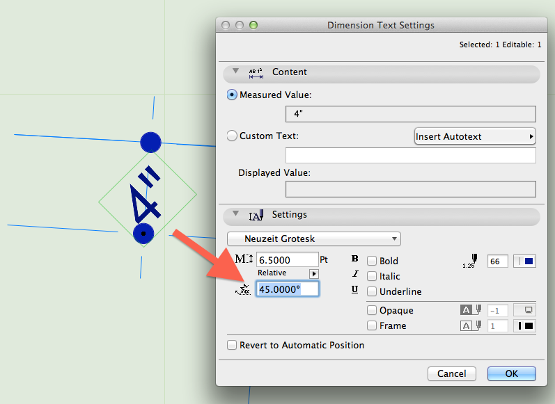

Eduardo Rolon
Option 1
Eduardo Rolón AIA NCARB
AC27 US/INT -> AC08
Macbook Pro M1 Max 64GB ram, OS X 10.XX latest
another Moderator
Eduardo Rolon
Option 2

David Maudlin
Rockstar
rob2218:
Thanks for adding the signature.
I was referring to eduardo's Option 2, which is also available in the Info Box when just the Dimension Text is selected.
David
