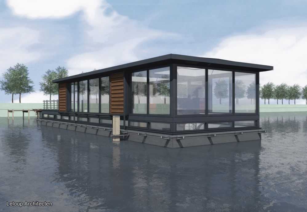

A 195x135 mm @ 300 DPI cinerender image with reasonably OK settings, should render out in under 2 minutes and a sketch render in a few seconds, bring these to photo editing software (photoshop or similar) and you can easily make more 'sketchy' renders that take little to no time.
With a bit more filter work (ideally saved as macros) etc you can create something like below in about 5 mins total.
