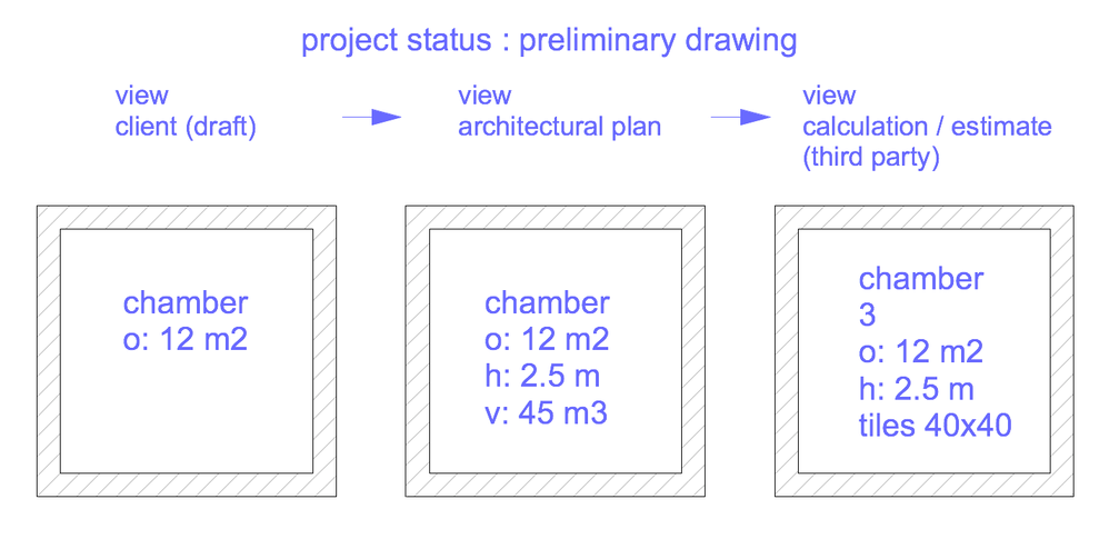

Matthew, could you explain a little further please? I must be missing something very basic.
How would you manage the zone representation, view by view, without changing the parameters / order list itself?
See image.
Main goal : one zone stamp per room, all parameter information included from the beginning, publishing 3 different views : simple / extended information...
I see, you want each zone to display view dependent information. Three ways I can think of (none too convenient):
1. Select all zones in 3D and change their settings prior to publishing. Tedious but clean.
2. Triplicate the zones on different layers. Ugly but automatic. Could create other problems depending on how you use zones.
3. Use copies of a library part as a zone stamp on multiple layers. Clean, automatic and flexible, but this requires obtaining the part and placing it in addition to the existing zone stamps.
There may be some new possibilities in AC13 but these would still require custom coding and I haven't had the chance to investigate in detail.

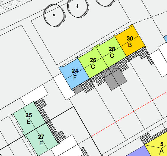

Slightly off topic, does anyone know how to modify the zone script so I can show the ID? In image below I use zone stamps for a survey plan. I have the zone name for street, zone number for housing number and the housing type is supposed to be the ID. This is very handy to generate many different shedules... Now I use one of the other existing parameters (f.e. flooring) for this purpose but whenever I change the zone definition this information is lost...
EDIT : a modified basic AC12 stamp with additional parameters 'custom 1', 'custom 2', ... would be even better. Off course I don't ask for free
Multiple zones on different layers is not an option. Mistakes have been made very fast
I've used option 1 many times before but I was hopeful for better ways. Most of the time, the more information I need to show from the zone, the less accurate the drawings need to be for my consultants. They ask tidy drawings with walls in contour lines, no 'hatches', no background colors, etc and then the model view options come in very handy... If zone representation could be managed the same way.........superb! Thanks for your time anyway.
