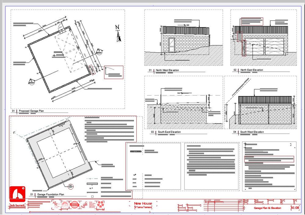

Since installing the latest hotfix 4022 our office has had problems where the 'Drawing Title' has been combining titles from various other titles on the same layout or combining the page name with the drawing title
this is not displayed obviously in the ArchiCAD layouts and only when printing or pdf ing the layout it only becomes visible then.
This has only become a problem with the latest hotfix and affects any older job files we open to test, on any machine, that were previously fine.
Anyone have any idea as to what is going on here? or a fix?
