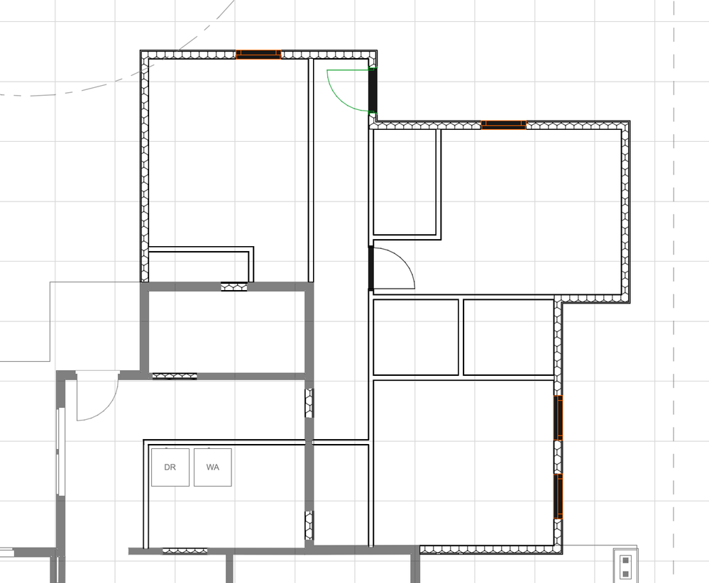

Achicad 26 door on floor plan
We just switched to A26. When I place a door or window in a new wall it appears black. Seems like a graphic override or model view issue or something but I can't figure it out. Screenshot attached.Screen Shot 2023-10-18 at 1.35.34 PM.png

have you checked your pens to see that it's still using the pen sets with the correct colour & settings?
we don't know what AC version you guys switched from so it's hard to figure out what settings you've accidentally hidden -- this can be easily missed if you've simply brought in your older Work Environment straight into 26. the new tools & their palettes will be hidden because of your old Work Environment settings.
check the settings of either the walls and/or doors & windows to see if they still have the correct settings. perhaps you used the door/window Favourites from the older version & their settings may have changed in the transition.

You mention a 'new' wall, so I would check your renovation filter settings.
arlouper
renovation filter seems to be it because I now realize the same thing happens to the doors and windows on the existing layer too.... but I can't figure out what to change.
arlouper
I fixed it. It was the floor plan and section tab of the window/door sections and plan/symbol fill background.
