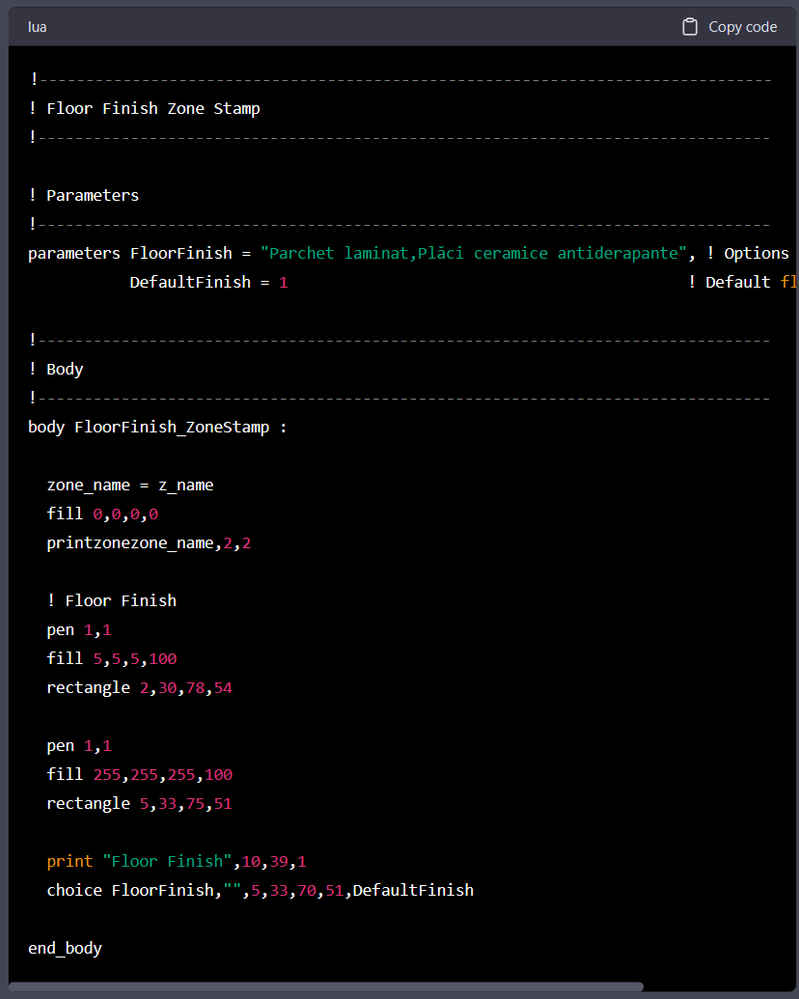

Meanwhile I asked ChatGPT to write me a script for the zone stamp to show me options for the floor finish setting.
"Can you write me a gdl script for a zone stamp to have the options "Parchet laminat" and "Plăci ceramice antiderapante" in the floor finish section?
Certainly! Here's an example GDL script for a zone stamp that includes the options "Parchet laminat" and "Plăci ceramice antiderapante" in the floor finish section: (see screenshot below)."
I have 0 knowledge of coding but archicad says it is wrong and tells me that there is some error on line with "fill 0, 0, 0, 0". Not sure why.

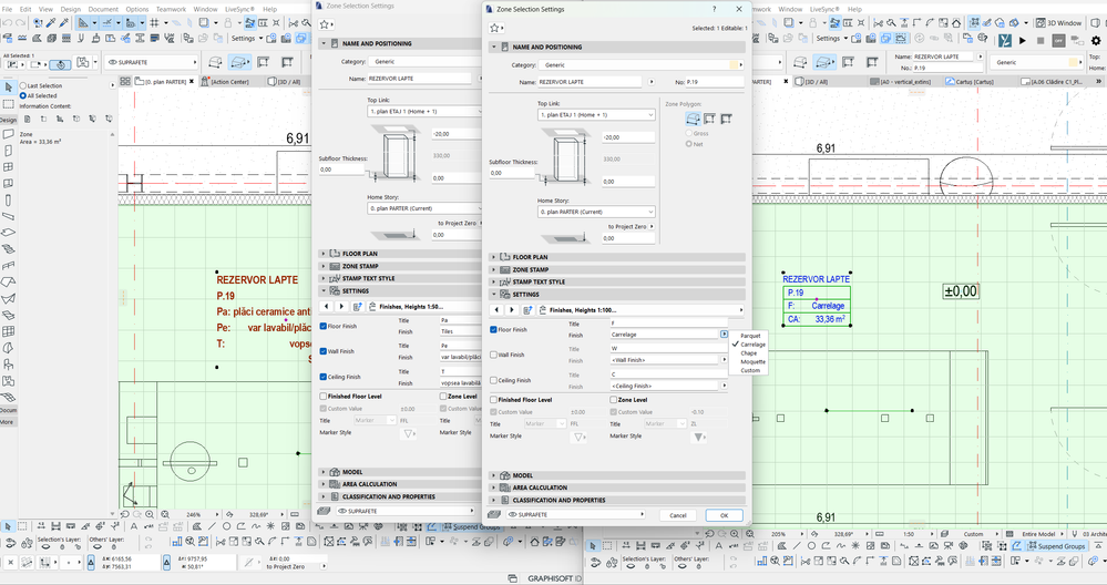

So, my god, that worked flawlessly. Thank you very much!
But regarding the context on which I'm doing this, if I save the changes I make in the zone stamp, it resets the format I previously had (I hope the screenshot helps rather than confuses). To save the "custom" settings on every modification I made on this stamp I have to do it in the stamp parameters in the GDL options? I'd be glad if you had the time to answer on this.
But again, on the problem I had, that worked like a charm. Thanks again!
Version 23 to 27
Lenovo Legion 5 Pro, Intel i9-12900H @5GHz, 32GB RAM, NVIDIA GeForce RTX 3070 Ti 8GB, Windows 11
Changing default settings in the zone stamp object, should not affect stamps you have already placed.
It will only affect new zone stamps that you place.
So existing stamps you will have to alter manually in each stamp.
Also be careful.
If you amend and save a zone stamp object, then if ever there is a library update, you will have to make the same changes again, because the amended object will simply be replaced with a new version that doesn't include your modifications.
You are better off to 'save as' the stamp as a new object with a new name, and save that object to your office library that is loaded into every file so you will have it in all jobs.
Then you use that new stamp instead of the existing one.
And if the Graphisoft library is ever updated, you will not lose your amended zone stamp.
