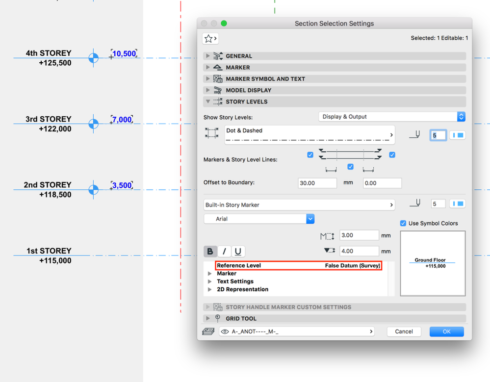

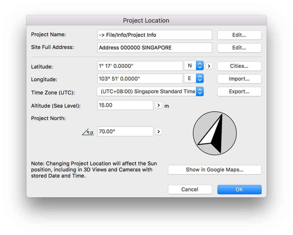

As a default, the location settings have 15.00 metres set for the altitude in the architectural BIM Submission Template of Singapore. Yet, when opening a Section or Elevation, it shows 115.000 – as required for submissions.
Upon checking the settings of those said viewpoints, the Reference Level option under the Story Levels panel shows False Datum (Survey), which ensures the conversion of 15 metres to 115 metres.
When changing the Altitude under Options/Project Preferences/Project Location to
i.e. 18.50 (metres), the Sections/Elevations will not update until we update the Reference Levels as well.
