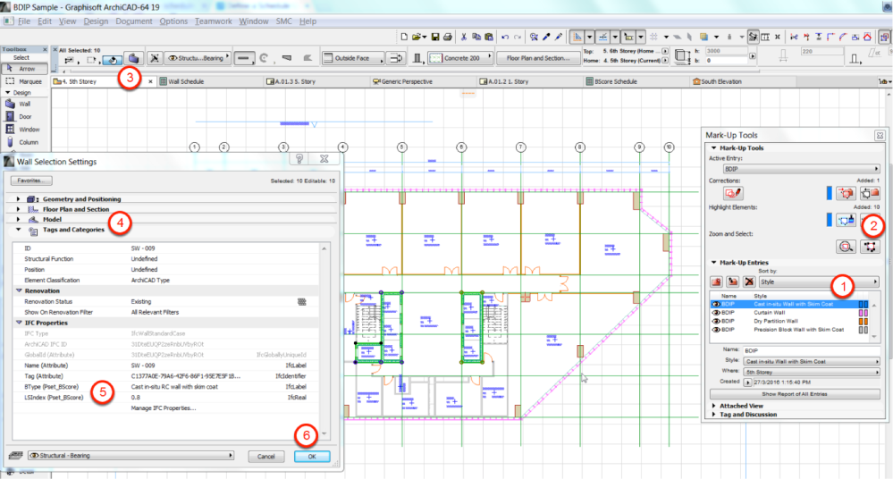

Assign Values for the Parameters
Use the mark up tool to select the elements and assign values for the parameters. Go to the plan view and activate Mark-Up Tools from Document/Mark-up Tools.
  1. Select the mark-up entry.
  2. Click on the Select Elements button, the elements will be selected in the plan on earlier assignment.
  3. Click on Settings Dialog
  4. Go to Tags and Categories
  5. Enter values for BType and LSIndex. Refer to Buildability COP’s Table 2 for values.
  6. Click OK.
Repeat the steps for the rest of the wall types.

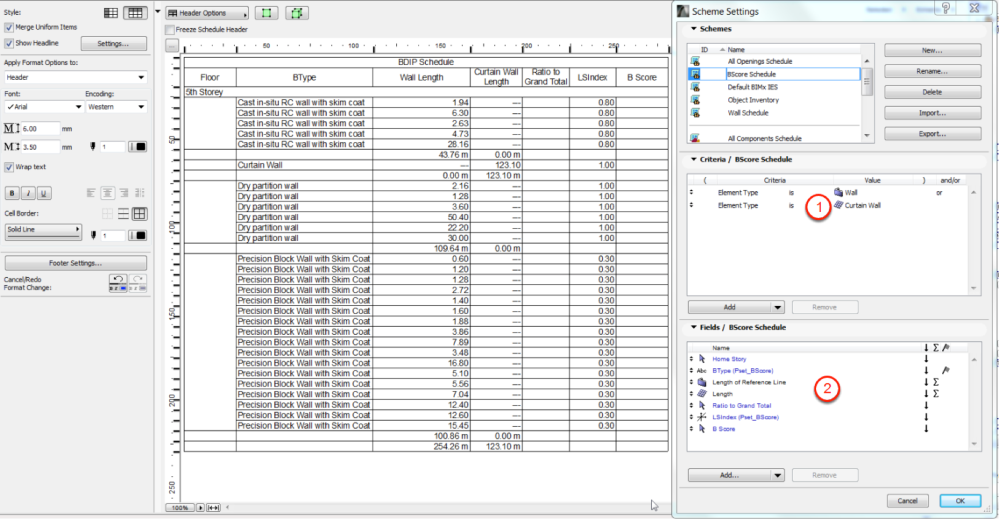

Create a Schedule for BScore
Create a schedule that lists BType, Length, Ratio to Grand Total in percentage, LSIndex and BScore.
Note: Refer to http://helpcenter.Graphisoft.com/guides/Archicad-19-int-reference-guide/views-of-the-virtual-buildin... on how to create a new schedule using Scheme Settings.
  1. Set the Criteria as Element Type is Wall or Element Type is Curtain Wall as the schedule include both walls and curtain walls.
  2. Add the following Fields as shown in the Scheme Settings below:
  • Home Storey – Wall’s parameter.
  • BType – IFC Properties, need to click on the arrow next to the .. button below to access IFC Properties. Click on the cell below the flag to group the schedule by BType.
  • Length of Reference Line – Wall’s parameter.
  • Length – Curtain Wall’s parameter.
  • Ratio to Grand Total – Custom text, this will be populated in Excel.
  • LSIndex – IFC Properties.
  • BScore – Custom text, this will be populated in Excel.
Click OK to close the Scheme Settings and see the schedule. Go to File/Save as… and choose to save the schedule as Excel file.
