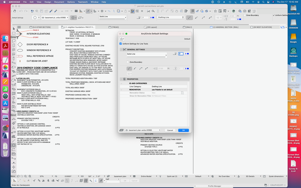

Suddenly the input fields for the arc/circle tool and the line tool have disappeared. Traditionally after setting the origin point, of either a line or circle, simply entering the desired length or radius on the keyboard would produce the desired size. Any ideas on how to restore these input fields? Below are two screen shots showing the open arc/circle settings dialogue and the drawing of a circle.
Operating system used: Mac Intel-based 11.6 Big Sur

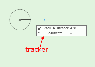

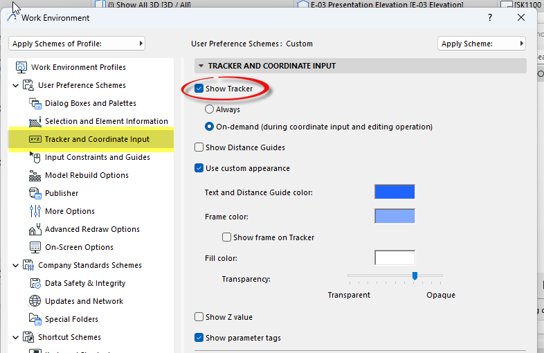

You mean the tracker is not visible?
There used to be a button in the standard toolbar, but I don't see it there any more.
But you can turn it on tin the Work Environment.
