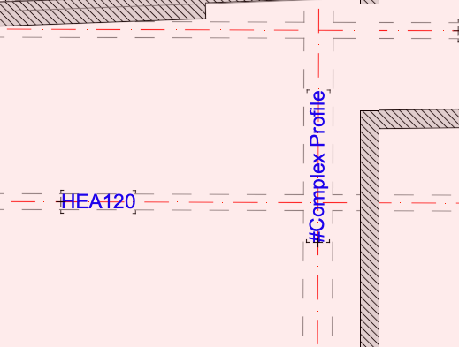

Autotext label on beam with segment
Achille Pavlidis
Is there a reason why the autotext label with #Complex Profile as setting does not recognise the complex profile of a beam with segments?
And is there any workaround to fix this???

Solution
Tim Ball
Each segment can have its own classification and properties and with its own auto text setting. I must admit I find it a bit annoying but if you do want to label each segment it is at least flexible.

Solution
It does, you have to TAB to the beam segment before you click to place the label.

Achille Pavlidis
OK, Big frustration! The tabing only works on the edges of the beam and not on the Reference Axis... is there a reason for this?
Mac OSX 13.6.6 | AC 27 INT 5003 FULL
So it does.
I don't know why.
Even though the reference axis is clearly divided with hotspots, I assume it is treating it as an over reference for the beam.
When you hover over the axis for the blue guide segments, it shows along the entire length.
