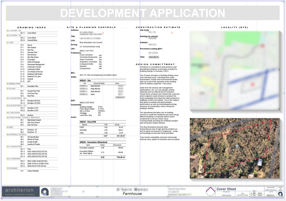

Really, does no one automate Floor Space Ratios?

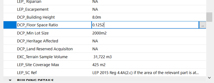

All I can suggest is that you have a 'master area' property that is associated to all zones.
It can be a just a value (area) that you adjust in the properties.
The downside is this value can not be locked (there is a wish for that already).
If left as 'default value' in the element settings, then it will automatically change as you adjust the property value in property settings.
It is just there is nothing stopping anyone from overriding that value in the element settings and once adjusted, it will remain adjusted until it is set back to 'default settings'.

Thats my frustration. Look I do have a much simpler GDL way using a text file as a global repository from about 20 years ago. It does all the % etc but my expectation was that it should all be simple stuff now. It also allows certain councils which dont count void spaces etc to be flagged with a dropdown in an object etc
Ultimately
Project Info should be accessible info whereby the choice of compliance/council is selected from a lookup table of preset parameters and used globally throughout the project, not just as a read only text but numeric via props and GDL ie a connected program exemplary of committee unity

I ended up setting up a discrete set of parameters in project info and piping them in but it was hard work and cost me a lot more time than it should have. Its possible to do pretty much all the compliance issues parametrically and just use the compliance bounds;  then use the maths in properties to generate all the tables which brings me back to the issue of not being able to append/subreports in layouts...missing for 20 years 😞
At least all of the data is live now
