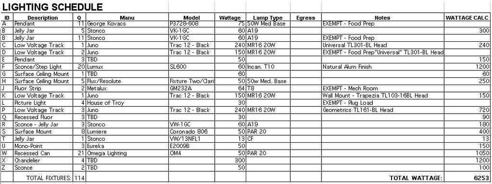

What I would ideally like to achieve is shown in the attached schedule below. If I could get ArchiCAD to total the wattage for each fixture type and grand total the wattage column that would be great. I'm willing to use the regular calculate menu if necessary.

What I would ideally like to achieve is shown in the attached schedule below. If I could get ArchiCAD to total the wattage for each fixture type and grand total the wattage column that would be great..
You're welcome. 😉
Well, you can do some of this, but not with the format that you show. To get a report that looks exactly like yours, I'd probably resort to exporting to Access/Filemaker or Excel.
You can subtotal by otherwise-indistinguishable-items in the I.S.. (E.g., all element that have the same values in all fields displayed in the schedule.) as shown in the attached screenshot for several library parts placed in a plan (I'm using the lib part name to distinguish the lamps ... rather than a model, etc.). Note the subtotals and grand total, but that they are on their own lines. (I didn't mess with fonts and line spacing ... trying to give a quick answer.)
Simply click on the 3rd button for the Watts ... which is the subtotal "flag".
