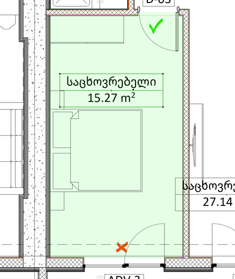

Hi. I have been creating my own Zone Favorites and got stuck with the Wall Recess calculation. The thing is that it calculates the recess very precisely with the Door Tool, but it can't calculate with the Window Tool. On the screenshot, you'll be able to see the contour of the zone going in the door at the top of the screenshot reveal, but ignoring the window reveal at the bottom.

Is the window sill above floor level?
If so it will not be calculated in the zone floor area.

The window sill sits on the floor level just like the door.
