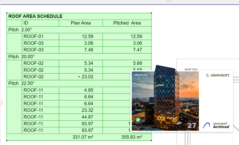

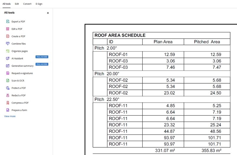

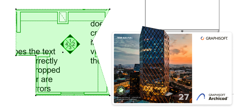

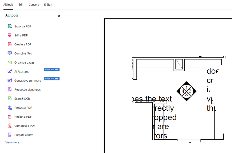

Hi All
The 5030 update is out.
The layout cropping has been fixed
Output in PDF
BUT,
the decimal point alignment is still just doing Right Aligned
In schedule:
On Layout:
And in PDF:

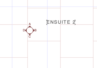

Peggie

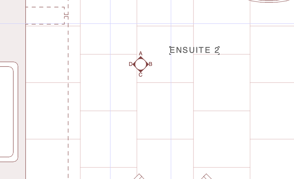

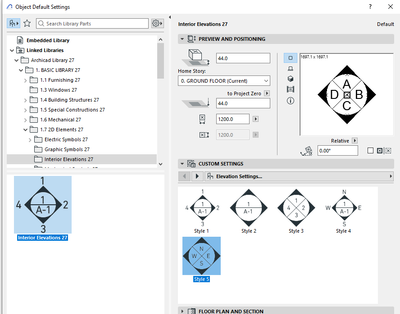

Hello!
Thank you for your reply, it's very kind. I have already placed in custom text. I guess I was more curious how Allan got it placed internally to the marker instead of externally like mine.
Allan's:
Mine:

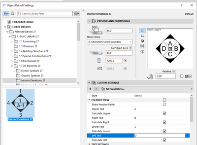

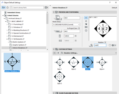

AllanP
The problem is that:
1. the Standard Archicad Library 2D Object does it,
2. but the Standard Internal Elevation Tool Marker does not do it.
The only way to get it is to "Fake It" (2D Marker Shown & Internal Elevation marker hidden) or
get someone with GDL knowledge to recode the Internal Elevation Tool Marker.
I recoded the Marker.
Sorry,
this does not help you get an automatic marker,
but does allow the output you are after.
P.S.
Style 3 will only show Numbers, Style 5 will display Letters.
