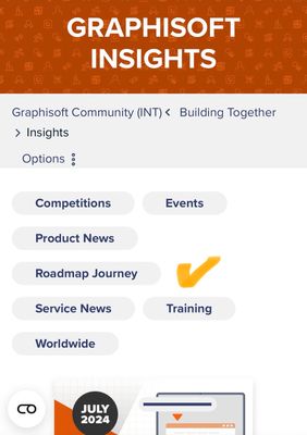

I think we’ve to wait until the review phase ends then results will be published in the same insights’ section, don’t forget to subscribe to the roadmap journey via this link.
https://community.graphisoft.com/t5/Graphisoft-Insights/bg-p/gs-insights
