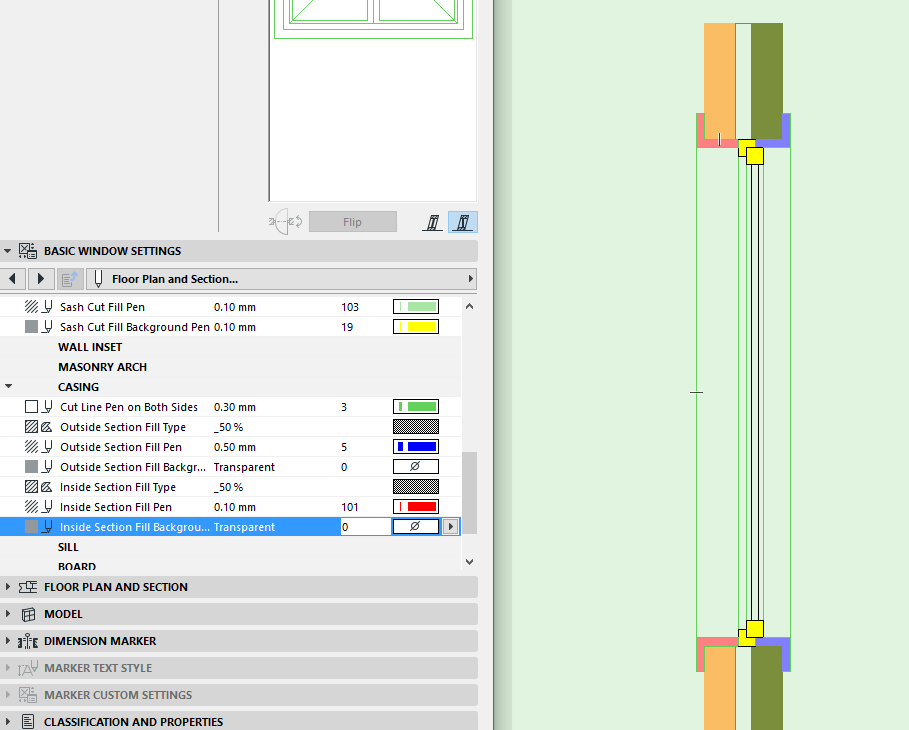

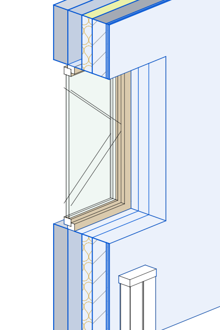

For the purposes of a project, we need to indicate that the casing on the windows are different, can this be done in a GO. At the moment I have had to overlay 2 walls and in the proposed wall change the casing colour (indicated in blue)
Is this possible and is this also possible to do in plan also?

Graphic Overrides act on the entire element, so anything you change will affect the entire window or wall.
So probably not the solution you are looking for.

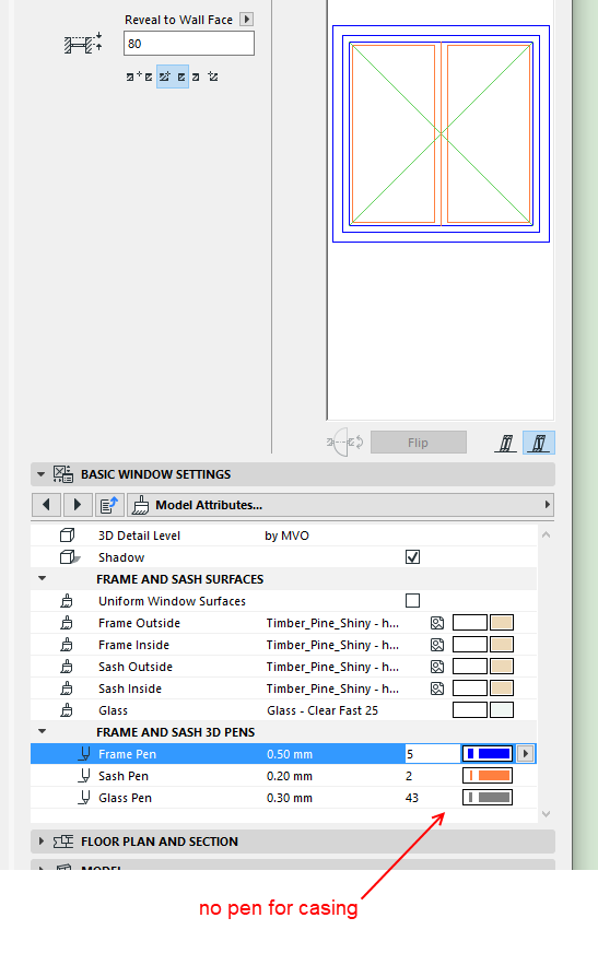

You could use a different pen for your casing variations. You can then use different Pen Sets to change the colour of the relevant pens when needed. Given, this will only change the colour of the contour lines of the entire window, which depending on the colour of your textures, may not always be very noticable.

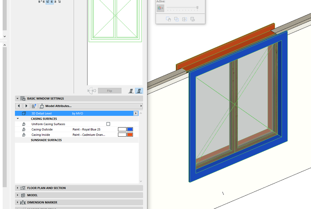

Seems you can change the material of internal/external casings.
And you can change the fills in section.
But I don't see a way of controlling pen colours in elevation.
The casing pen is the same as the frame pen.

It just uses the frame pen for the casing contours, but at least you can swap out the pens via Pen Sets without the issue of completely changing the visual of the window.
Ling.
But the casing pen will always be the same as the frame pen.
