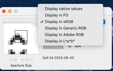

Digital Color Meter can use multiple color spaces. In Native Values, the red wasn't even close to (255,0,0), but in sRGB ... even though the pen is set to pure (255,0,0), the meter reads (255,1,0). Instead of (0,0,255), pure blue reads as (8,0,255). Pretty close anyway...why not exact is a small mystery.

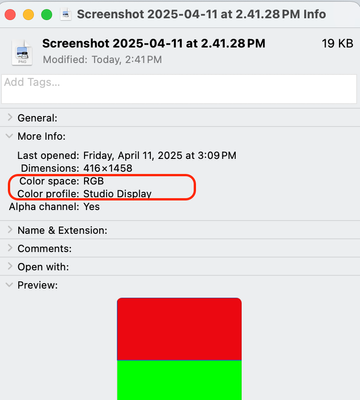

On the drawing that was saved as a screenshot ... the PNG image (I set my screenshots to save as PNG instead of JPEG for better quality) and the placed drawing have identical - but different - colors. The pure red swatch became (235,8,17), green did not shift... (1,255,0), and blue (15,0,255). Almost no shift to CMY and gray. That difference from yours is purely up to the color profile of my monitor. Totaly weird... but this is on Apple, not Graphisoft. In the Graphic Artist community, the advice is to take any screenshots received from clients... all of whom would have had different monitor profiles... and export them from Photoshop to jpegs with the option to convert to sRGB. That seemed to work.

PS. If you do a Get Info (cmd-I) on the screenshot jpg (png for me), you'll see both the color space and the color profile such as the below screenshot. When I changed my monitor to different profile settings, that showed here... and the color shifts differed. I have no idea why Apple thought this was a good idea.

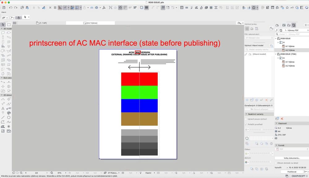

I did the test again without using printscreen, so as not to involve Apple's bugs in the problem.
I created the right part of the image by exporting the left part from AC using Command+P > PDF > Save as PDF. I converted the PDF to JPG in MacOS and then inserted it as an external drawing into AC. Then I published the whole thing using Publisher to PDF. Compared to the previous test, slight deviations to other shades has almous disappeared, but the changes in darkness remains above the tolerable limit. It is very strange that the shift in darkness is different for each shade, some are almost identical, while the further away from the basic RGB shade the more pronounced the deviation.
I would like to disagree that this is not a critical issue. Many of us use AC as a tool for architectural work, where layouts contain a large number of visualizations and other images, and this is a really big problem not only for interior projects. I looked at the released AC 28 hotfixes, no fix was important for me (I didn't notice any stability problems either), fixing this problem is absolutely crucial for my work.
export result
prinscreen of AC interface before publishing
