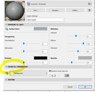

dhnguyen
I'm not seeing "Vectorial Hatching" in my Surface Settings. I'm only seeing "Cover Fill Foreground".
In my Elevation Settings, where do I go to "turn on Vectorial 3D Hatching"? 
