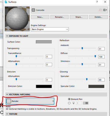

3 things:
have you associated the Surface with a fill in the Surface Settings?
check your Graphic Overrides & ensure that you're not using a GO that's showing all fills as empty. i believe it's an Out of the Box GO.
check your Elevation Settings & make sure you've turned on Vectorial 3D Hatching.

I'm not seeing "Vectorial Hatching" in my Surface Settings. I'm only seeing "Cover Fill Foreground".
In my Elevation Settings, where do I go to "turn on Vectorial 3D Hatching"? 
