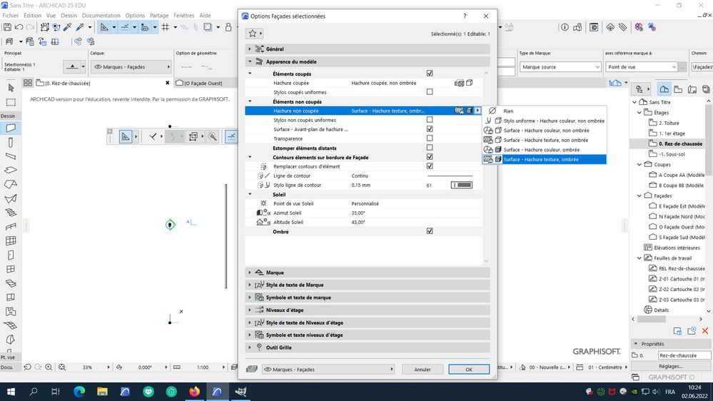

My concrete is showing up properly in my rendering. If I switch to 2D elevation view, it shows a white background instead of grey. How do I change this so that my 2D elevation view shows a grey tone. â€ƒ
I dont want to create a 2D fill. I've done it too many times in the past... there must be a smarter solution out there that I'm not aware of.

Gerry Leonor
3 things:
have you associated the Surface with a fill in the Surface Settings?
check your Graphic Overrides & ensure that you're not using a GO that's showing all fills as empty. i believe it's an Out of the Box GO.
check your Elevation Settings & make sure you've turned on Vectorial 3D Hatching.

BrunoH
since Archicad 25-2 there is an option to show textures on sections and elevations.
Select your elevation mark on the plan view or your elevation name in the navigator.
Open the elevation options dialog boxe and shoose the option you want for non cut element fill (see attatch).

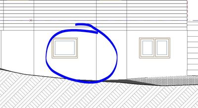

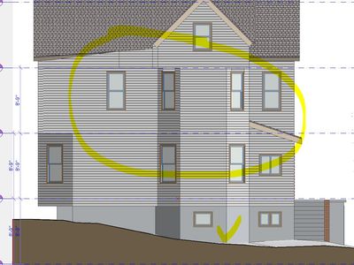

Thanks, this option looks nice. It turns on the shading for the concrete which I like. But it's showing several different shades for the walls above. I guess I have to play with this option to have it 1 constant shade.

Hi DNguyen,
When your textures use regular repetitive pattern you will have to adjust the texture origin of each element to the same position.
