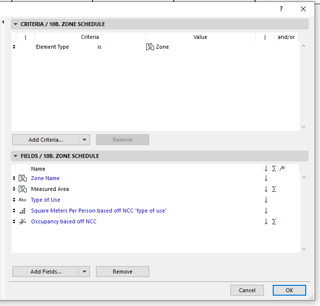

I know nothing about 'top-stamps' but for zones the criteria simply needs to search for element type = zone.
The fields you want depend on the information you want to extract.

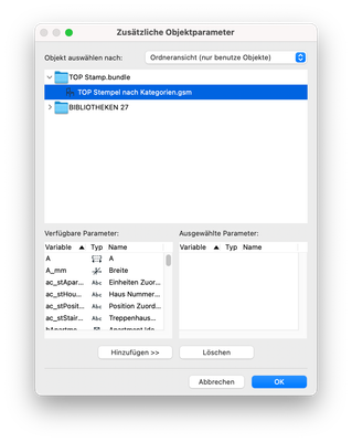

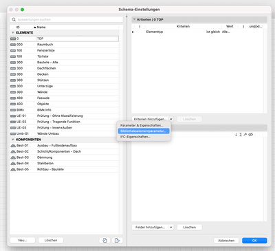

The TOP-Stempel is an object and can be searched in the schedule as an object with the Bibliothekselement-Name. Also further Bibliothekselementparameter can be added for the TOP-Stempel in the schedule.

Please keep in mind that the TOP-Stempel is an object that is exclusive for the AUT/CHE Version, so it is better to ask in the German speaking community about this feature, since it is not included in the INT Archicad Version.
