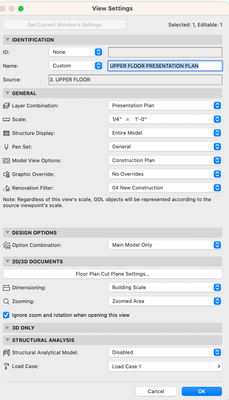

I have one design option set up, along with the Main Model. However, it the custom design option is not available in the View Settings. Only the Main Model is available to set in the View Settings

Hi @svpribyl,
I think in your case you can go further for creating a new DO combo as @thesleepofreason suggested or rather you can:
1) Select all elements & objects inside Option 1 then click on Main model then Relink.
2) Create a new Reno Filter & name it Option 1 then assign all elements & objects inside that DO into the newly created filter & activate Option 1 Reno filter in view settings dialogue.
