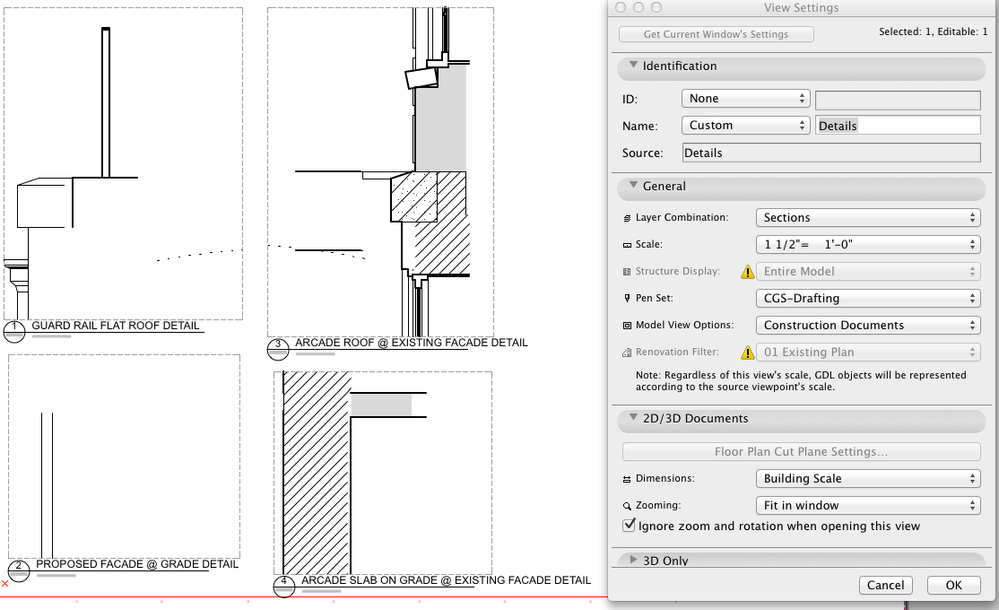

Hello I'm new to ArchiCad, love the program.
I have an issue with detail drawings on my layout sheets.
It only shows my existing part of the drawing, all the new stuff doesn't show up.
I can't change in view mode the detail setting for the renovation filter?
Why what is the reason behind that?
Thanks
2 Replies 2

This issue and some workarounds are discussed here:
Can't amend renovation status in viewset created from detail

I can't believe that we are unable to assign reno filter to non-auto re-built view.
What a SHAME!
