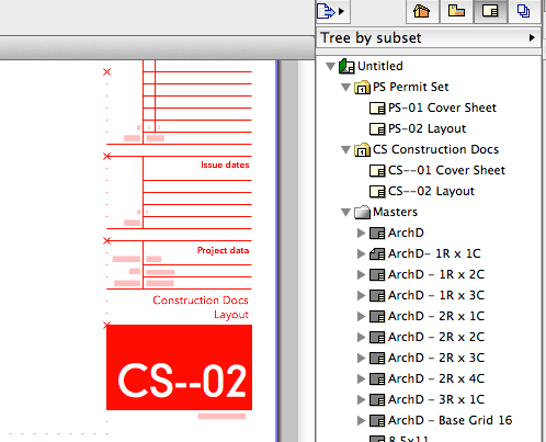

You can try using Folders - See Attached or you could use another Archicad file for Layouts only, keeping the model and construction set in one and linking to the CD model and having the Permit Set on another.

Thanks a lot, I think I'll use folders for now.
Wait... it still doesn't solve the Sheet number problem. I don't get the right sheet numbers -_-. I guess I'll follow your instructions and save two separate files.

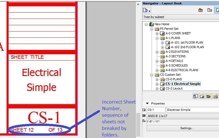

Sorry for not clarifying. You see the layout settings only govern the Layout IDs, there doesn't seem to be one that controls the Sheet Number... I mean the total number of sheet instead of the sequence number of the sheet ( which is it's ID ). See attached image.
I don't think this is possible to achieve with Autotext the way you intend if you have Permit Set and Construction Set in the same Layout Book.
This is because these two Autotext item: Layout Number and Number of Layouts are calculated based on the whole Layout Book.
Actually it may be a good wish to have "Layout Number in Current Folder" and "Number of Layouts in Current Folder" Autotexts. Then it would be possible to do.
