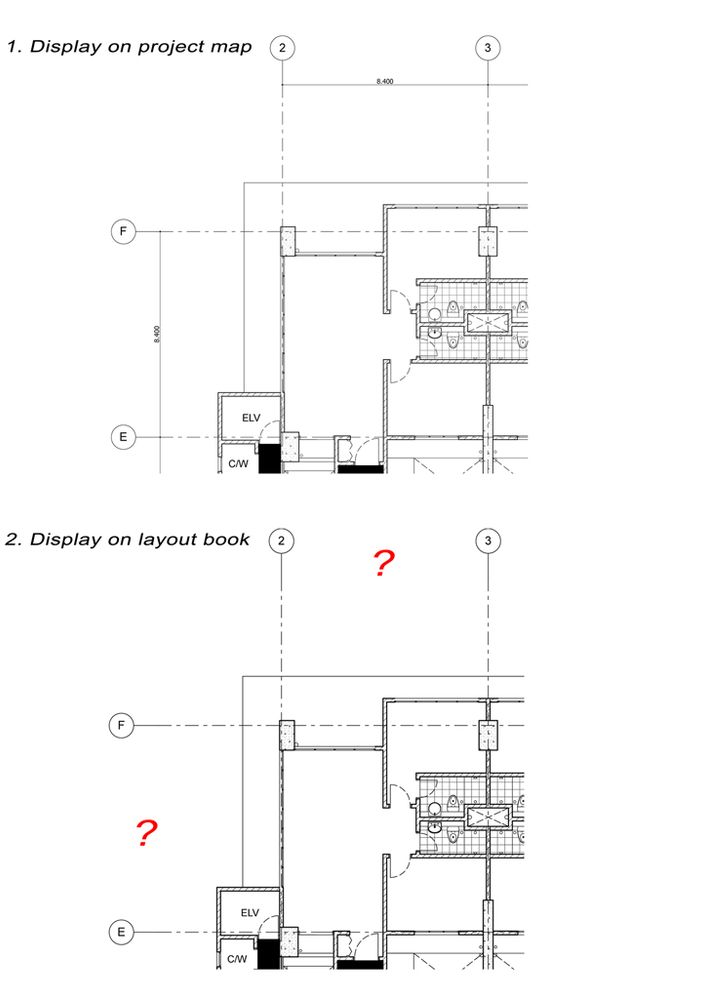

My grid and dimension can display on project map, when i place my drawing on layout book, the dimension cannot display but the grid have to display... Anybody know about the setting? Thank you

check if the view placed on layout matches the settings you have in your project map.

Check your layers and Layer Combinations.

Select the Drawing on the layout.
If you right-click, the context menu will show the Open Source View command. If you use this command it will take you to the source of the Layout and display it with the View Settings it is currently displayed. Then you can see if the layer combinations and other settings result in what you want to see.
You can also use the Modify Source View Settings command to change those settings such as Layer Combinations to display those dimension layers.

Thank You very much
