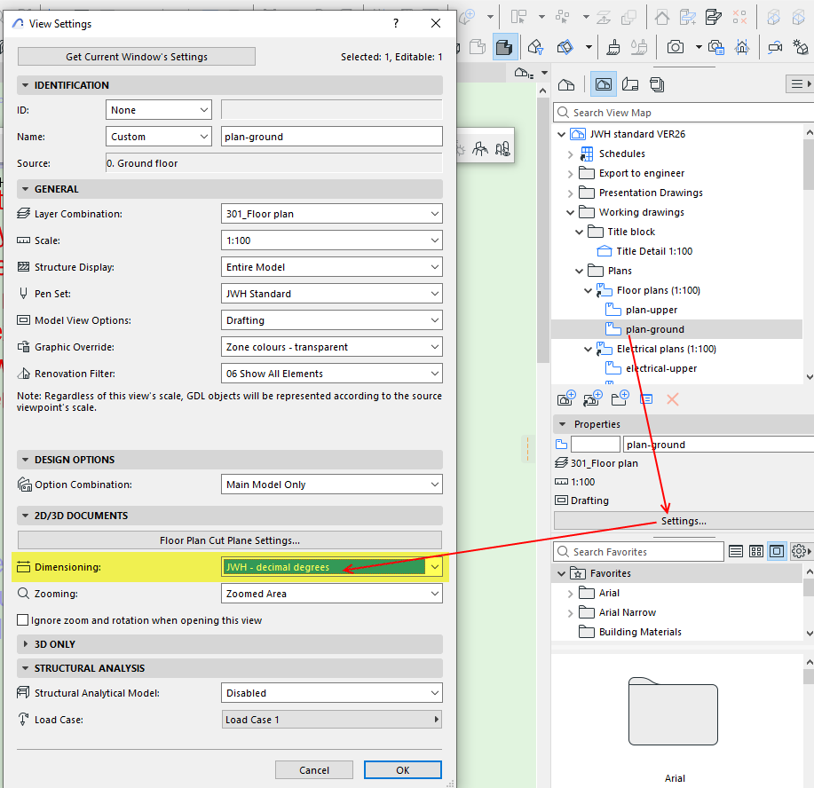

Seems you have updated your dimension styles which is great.
Now each view you open stores the dimension style, so you need to make sure the view settings are using the correct dimension style.
Every time you open a 'view' all of the settings will change to what is stored in the view settings.
you can change the settings on screen, but these will not affect the saved views.
