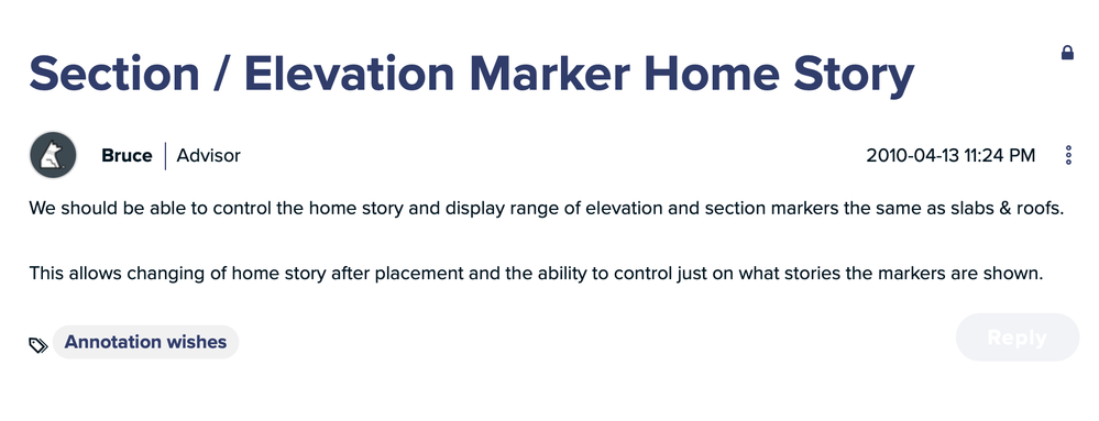

Which makes me wonder about the purpose of having a Home Story one can't control. If I am not missing something big, please GS fix this.

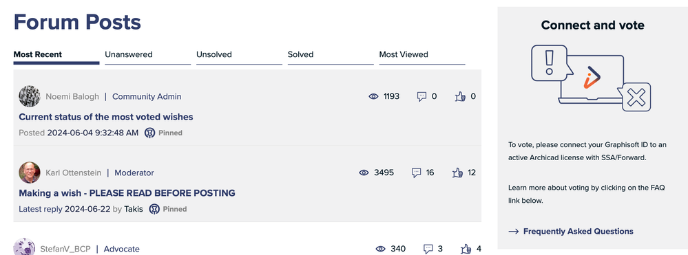

[There are two 14- and 19-year-old posts mentioning this, in Wishes and Documentation, to which I can't reply, and of course I can't post a wish either. Which makes me wonder about the purpose of]

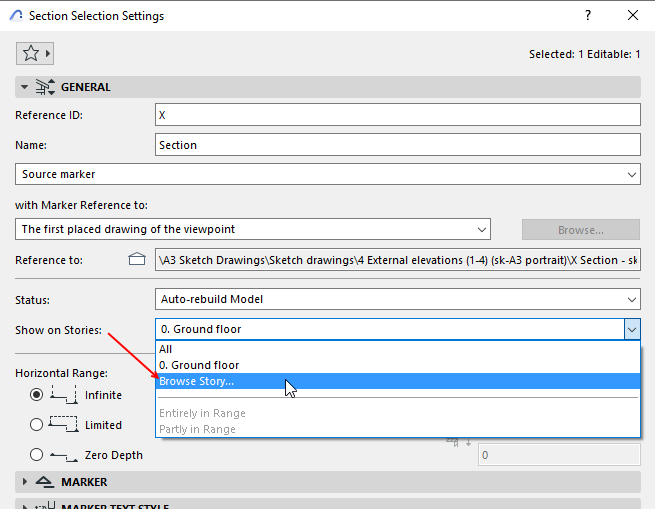

@Ignacio Azpiazu wrote:
Now the section marker’s Home Story can't be controlled from its settings
Are you sure you can not just browse for the storey you want to show it on?
That control the stories the marker shows on. Not the Home Story, which is where Select Section marker on the Home Story and zoom to it  takes you to.
I just changed the storey of a section marker and the Select Section marker on the Home Story and zoom to it takes me to that marker on the new storey that I just set.
It no longer shows on any other storey.
How did you change the Home Story of an existing marker?
As shown in my previous image.
You browse for the storey you want the marker to show on and that sets the home storey.
I just tried it and it works, by some mistake in the interface, which mixes up stuff: that setting controls the stories you want the marker to show on. Typically markers show on All, Partly in range, Entirely in Range –where they show has nothing to do with their Home Story, which is the reason the markers can show on stories which are not their home story and also, as in the case I am dealing with, not show on their home story.
Now when you set the marker to show on some specific story only, it does change its home story, behind the scenes and without letting you know. So if you want the markers to keep on showing where they are showing, but change their Home Story, one needs to modify Show on Stories to the story meant to become the new Home Story, and then restore Partly in range or whatever.
One needs to change the section settings from the current home story (not a “show on” story) –set the marker to show on All, then go in this case to -16, and modify it to show on 0 from there. If one grabs the (current home story -16) marker on 0 and changes it to Show on 0 (where it already shows, being in range; but the idea is to force it to change its home story), it will disappear and show on -16 only. There is some legacy thing severely messed up.
So thanks Barry for the workaround, and GS fix this mess.

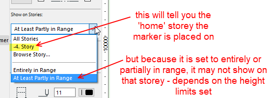

For what ever reason, your section markers has been placed on storey -16.
It must also have a limited height and that must be set to Project Zero or some other storey?
Then the marker is set to show 'at least partly in range'.
So it shows on your ground storey (or where ever) which is fine, because that is what you want it to do.
Now you go to the section view and choose to select & show marker on home storey.
It takes you to storey -16 but there is no section marker to be seen, because it is limited height and will only display on the storey that is in that height range.
So the problem is you can not see the section marker?
Fortunately it does still select the section marker still, so you can go into the settings and then set it to show on the storey you want it to be on.
This will reset that as the home storey.
Then if you need to, you can set it back to show entirely or partly in range, as the range that it is set to display will not change.
It the marker does not have a limited height, it can not be set to show entirely or partly in range and can only show on all storeys or a particular storey.
Fortunately, resetting the 'home' storey is as simple as picking it in the settings.
