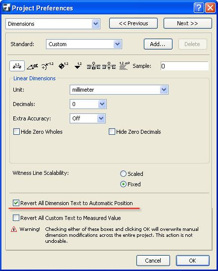

Does reverting your dimension text resolve it? Options> Project Preferences> Dimensions...

Hi link, and thanks for the reply and those instructions, I thought yeh that sounds exactly what my problem is, unfortunately that didnt work, seems that if I go and work in the garden for half an hour and comeback it works, cant work out what Im doing that is making it not work one minute, then it works the next? Hmmm......
Anyway if I have to , i'll just do em manually, otherwise Im going to have the best looking strawberry and tomato plants in Australia.
OK, I worked it out, When I do it in the project map it mucks up, but when I do it in the VIEW MAP it works out fine, so it wasnt my strawberries.

I think this is certainly a scale issue. It appears that your dimension text size is being placed as a "fixed" size, which will get screwed up when the scale is not correct. (Changing to a view using the Project Map doesn't change scale properly, whereas using the View Map does (as long as the scale is saved correctly), as you've discovered.
I think you may get better results using scalable dimension text, rather than fixed. (i.e. your dimension size will show up as "points" rather than "mm".) However, I spent a little time trying to see how to change my own dimension text from scaled to fixed, and couldn't find where to do this, so I don't know to go the other direction. The issue never came up for me before.
