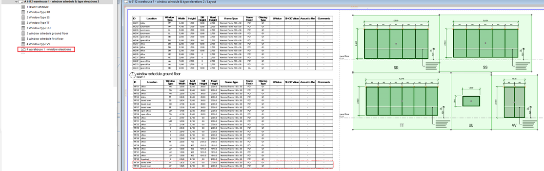

Gerry Leonor
it sounds similar to how we doing our Window Schedules.
a window will be scheduled & presented twice on one layout.
  • first as a hardware schedule (dims, type, location, ID) on the left-side of the layout
  • second as a 3D image with overall dimensions & window type, on the right-side of the layout
there is actually a 3rd drawing in this setup.
it's a drawing that sets out the dimensions of the mullions/transoms/sashes. it sits directly below a laid-out group of the Window Type Elevations.
screenshot below. i've hidden the window type elevations for clarity.

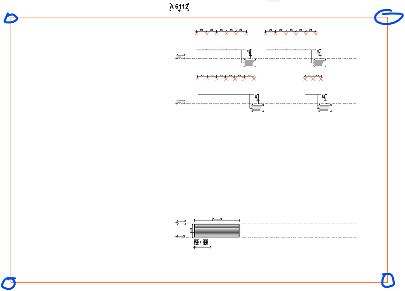

now, the reason we did the 3rd drawing (as a Worksheet) is because there was (still is) a chance that if the internal (non-overall) dimensions were done in the 3D Window Schedule View, it would disappear if, say we change the window from one type to another. there were times that even a simple update of the 3D schedule. to make this work, we do a Trace Reference of the layout into a worksheet & use hotspots & dimensions to measure the mullions & sashes. keep in mind that the alignment of the Layout & the Worksheet. I've drawn a red border to indicate the over-all size of the layout in the worksheet.
it's not perfect & again, another duct-tape workaround, but it's been workable with us for years. perhaps if we can have the dimensions not disappear in the 3D Schedule Elevation it would make this process much smoother. to be fair, i haven't tried to disprove the idea that these dimensions disappear for a while now & not since AC22.
