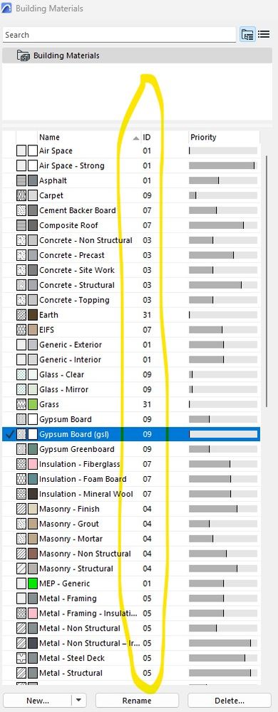

Bldg. materials ID
Gisele
What do the Bldg. material IDs refer to?
AC 26 - 5002 USA FULL

Solution
Tim Ball
In my view they are just placeholders
There is no real system out of the box
I created my own naming system to suit my workflow
You could also use any localised classification system you prefer if you are collaborating

Solution
JeffH
I adjusted all of them to be each material's respective CSI Division Number, so that they all are able to sort correctly.
03 is all the concrete Building Materials
05 is for Metal
06 for Wood
07 for Insulation
etc.

Thank you, Jeff, for the tip!
