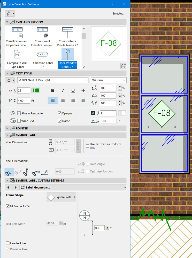

JeffH
You can use an associative label, and then select the Door Window label that is loaded into your version of Archicad you are running.
AC24 / AC26 / AC27
Win10
Go to post

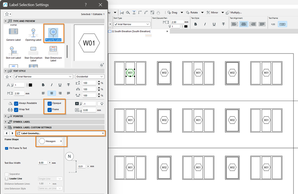

Ricardo Lopez
Hi @pcrossington
You can use the Property Label Type or Opening Label and change the frame shape, text, etc. to match whatever you need and save it as a favorite.
If you want to label all the windows at once in the elevation view:
  1. Select the Window tool.
  2. Ctrl (Command)+A to select them all.
  3. Menu Document> Annotation> Label Selected Elements.
Ricardo López, M. Arch.
Go to post

JeffH
AC24 / AC26 / AC27
Win10
Ricardo Lopez
Hi @pcrossington
