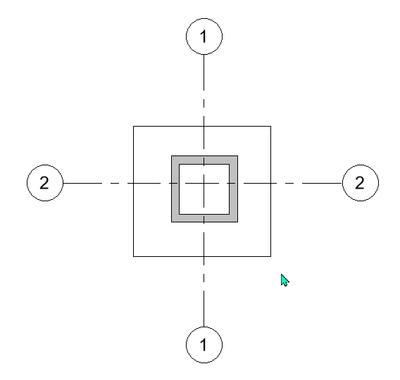

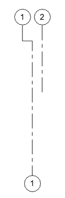

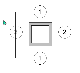

I'll give you an explanation based on REVIT.
In the floor plan we create Callout, Elevation and Section.
However, the location of the bubble on the grid must be different.
For example, the Elevation showing the 20th floor and the bubble above the copied elevation should be different.
In the case of Rabbit, you can freely specify the length of each copied Grid and the position of the bubble.
However, ArchiCad is only divided into floor plans, elevations, and section views.
In elevation and section views, you should be able to reposition bubbles between drawings with at least infinity and height limits.
Position adjustment is also possible in the case of archicad's detail corresponding to revit's callout.
I am saying this because it is strange that archicad, which has better performance than revit, does not do this.
plan view

And I wonder if this is not in ArchiCAD? Another thing with the question is, I am surprised that the fake that Barry answered in 2011 is still valid for the phenomenon that the dimensions of the grid, centerline, or object that have not been deleted in Detail disappear after rebuilding.
I didn't think that it couldn't be interlocked with AutoCAD.
If it is not possible due to the detail structure, shouldn't it be possible to add a function that can crop the floor plan like revit?
Substitutes with other fakes are possible.
However, I think that this can be seen as a fatal weakness of ArchiCAD from users of REVIT.

When I try to lower the bubbles in the section view, only one bubble is lowered. I can't fit the line at once with the method I know, such as stretch.
I would be grateful if you could tell me how.
AC27 on window 11
You can turn off the bubble on one side in the Floor Plan and adjust the length of the Grid Element to achieve this.
Yeah, it looks like they can be edited graphically in Section/Elevation only one by one.
Select the Grid Elements, go to their Settings Dialog, and modify the level of the Top Marker in the Section/Elevation panel of the Dialog.
