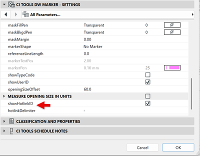

Here is how to set the Master ID of the Hotlinked Module and the ID of Doors/Windows in the source file of the Hotlinked Module.

Thanks.  Also found what looks like a couple of relevant parameters in CI doors 'All Parameters' tab (that is not exposed as part of standard UI) that could do the trick.  Have not played with it yet, but looks promising
