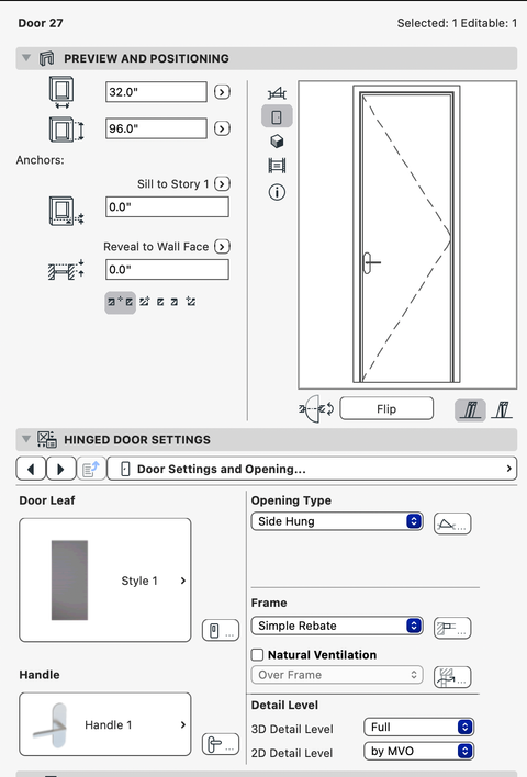

Hi! I have a strange situation. Doors are set up well, and showing handles in 3D, but not in elevation.... I checked model views, doors setting... can't find what's the issue this time..

Hi cocoloco,
In MVO, did you check this one?

Lee Hankins
Have you checked the settings in Model View Options under Detail Level of Doors, Window and Skylight Symbols to make sure handles are turned on in elevation?

cocoloco
I had all on. Believe it or not..... after restarting archicad, all of the sudden we can see now handles.. Very interesting
