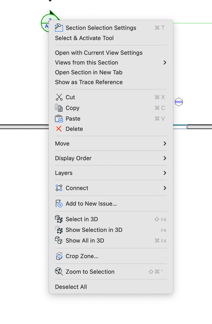

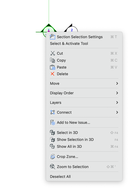

some section markers give you the "open view with current settings" and "open views from section" options, others don't. They are both source markers, they both have saved views (both are in the same clone folder of the view map). What gives?

The only way i get that to happen is if the section type is an "Unlinked marker"
can you access the views in the cloned view set?
I have had corrupt drawing before where things misbehaved.
have you tried an open and repair?
