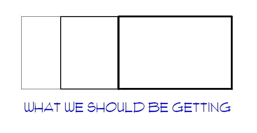

Sorry I didn’t get back sooner…but here goes….I will be a little clearer on what I am talking about…in this example….. here is a floor plan and I am cutting an elevation…if I cut an elevation/section….there is hardly any control over the line weights… especially when it comes to elevations…at least I have one option when cutting sections…..so what generally happens….a elevation/section is cut….my draft person copies the cut within that view and the elevation/section become dissociated with the model and this doubles my work….…..so this really needs to be addressed…examples below...
here's the cut....
this what we should be getting....some line weights...

"limited near/far control" only provides for one additional line weight...I wish there where more....or maybe it should occur in part......unless there's something I am missing....

My personal preference would be a generation algorithm which allows users to specify "for every <xxx> feet, adjust pen number <yyy> positions in the <zzz> direction. Anything that reaches below 0 is not shown"
This would give an endless variation in pens based on depth, and allow the user more control.
