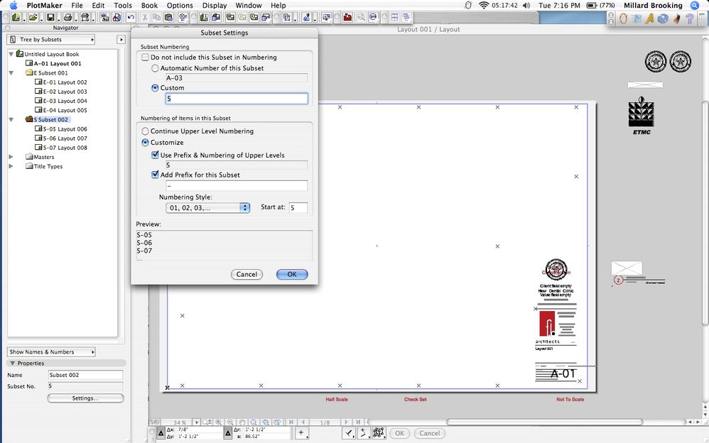

We do use prefixes and subgroups but are having trouble making our numbers consequetive, regardless of the subgroup. For example, existing drawings have the prefix 'E' and usually start with '01' and go to, say, '04'. Sketch drawings have the prefix 'S' and would preferably start with '05'. However, it keeps defaulting to an ''01' start with each new subgroup.
The automatic numbering is so convenient that we use it all the time, regardless of this apparent limitation. Maybe we need to look harder to get around this!
Kees
If you look at the Subset settings, there should be a "Custom" setting for numbering, and a "Start with" value. Sorry I cannot be specific, but for once in my life, I am neither at work not at a machine with Archicad on it!
Kees
Check you subset settings. In there you can designate what number to start from.
KeesW
Thanks for your prompt reply - don't archicad users ever sleep!
Yes we can manually nominate a starting number. But we think that it won't renumber automatically if we insert another layout in the middle of a drawing set. Suppose we have four existing drawings (ie E01, E02, E03, E04), and twenty sketch drawings starting S05, and say 100 Working drawings prefixed 'W'. If we add another 'E' type drawing, we will have to remember to renumber the 'S' group to start with 06 instead of 05, and the 'W' group, and any other group that follows. Hopefully it will then renumber all the layouts in the group.
Kees
While it is true you would have to change the starting number of each subset, it is still much easier than erasing and re-lettering all of those sheets by hand. Anybody remember Kroy? oops... I actually meant Leroy. Kroy was much more advanced. The time saved depends on what you were used to before.
