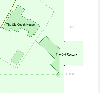

Occassionally I need to crop a drawing's boundary when placed on a layout to exclude some items ( the grid number references as an example on the attachment) however, archicad 27 doesn't do this properly. It only crops the outside frame extremes based on regular rectangle. Is there a new function I need to check or is this a glitch as currently I'm having using masking shapes. Never had this issue since v.11 when I started using AC.

As an update, it appears that when I print to PDF the items outside the cropped frame doesn't print, which is good, but I'd still prefer to be able to hide them. Sometimes, I have to do some complex cropping when I place 2 floorplans together due to split floor plans / offset FFLs and this makes life harder.

In this Archicad universe, seems you are not alone!!!!!!!!!!!
https://community.graphisoft.com/t5/Documentation/BUG-in-Layouts-AC27/m-p/576125
