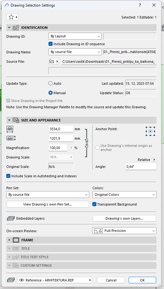

Hi everyone,

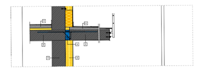

Soon after starting a new project in Archicad I've noticed that upon placing external drawing in an independent worksheet the geometry is slightly rotated. The declination does not register on measure/rotate tool but is perceptible visually as you can see from the attached images below.
Since this is a fresh project my first thought on where the problem might lie is the template file from where I started. But which option/setting could do this, since project north (my first suspect) - I assume - does not effect worksheets, or it does?
Has anyone experienced this problem?  Suggestions appreciated!

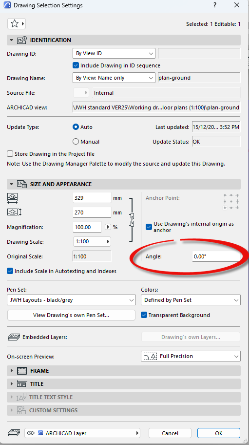

It is not a problem with Archicad.
It is just the default setting you have for the drawing tool.
Change the angle to 0° before you place the next drawing and they will all be at 0° when you place them.
The software only does what you tell it to. 😁

Thanks you, here we have the culprit:
Ive imported 2 different drawings (one CAD of mine and one downloaded from a producer) and the angle is the same on both. So the problem is in Archicad.
Do you think its the program in general or something in the template file?
