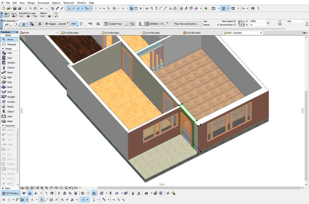

Edge material prioritized over outside surface material
In my model, there is one corner where the edge surface material is visible instead, and I can't figure out why. See screenshots below, two where the walls selected if it helps.

Rico
You need to select this option:
I don't remember what it is in english but it should be self-explanatory.

DangCad
Perfect! That solved it, never seen that option before. Thanks!
